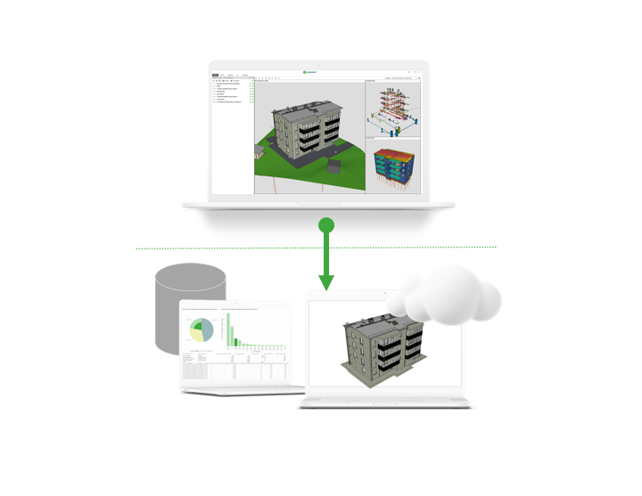

The final step of data processing is to format the data in the right way for further use. Maybe your BIM data will go to a CDE (common data environment), BIM platform, or some kind of project bank. Or maybe it will be shared with many parties and systems. In practice, there usually isn’t just one data storage in use. Different parties in the construction project need to manage and archive their data in their own environments. It doesn’t really matter. Simplebim can serve them all. The whole process can be automated with dataflows.
Being able to export the processed data back to IFC is what makes Simplebim different from most of the open BIM solutions. Simplebim is a truly open solution. The data processed by Simplebim is not trapped inside Simplebim. It can be shared in an efficient and flexible way to any BIM solution ecosystem.
Simplebim can export BIM data to: IFC, CSV and Excel.
Note that we are talking here about how the processed data is formated, not where it is used. The whole point of open or commonly used formats is that the data can be used in many applications and platforms.
